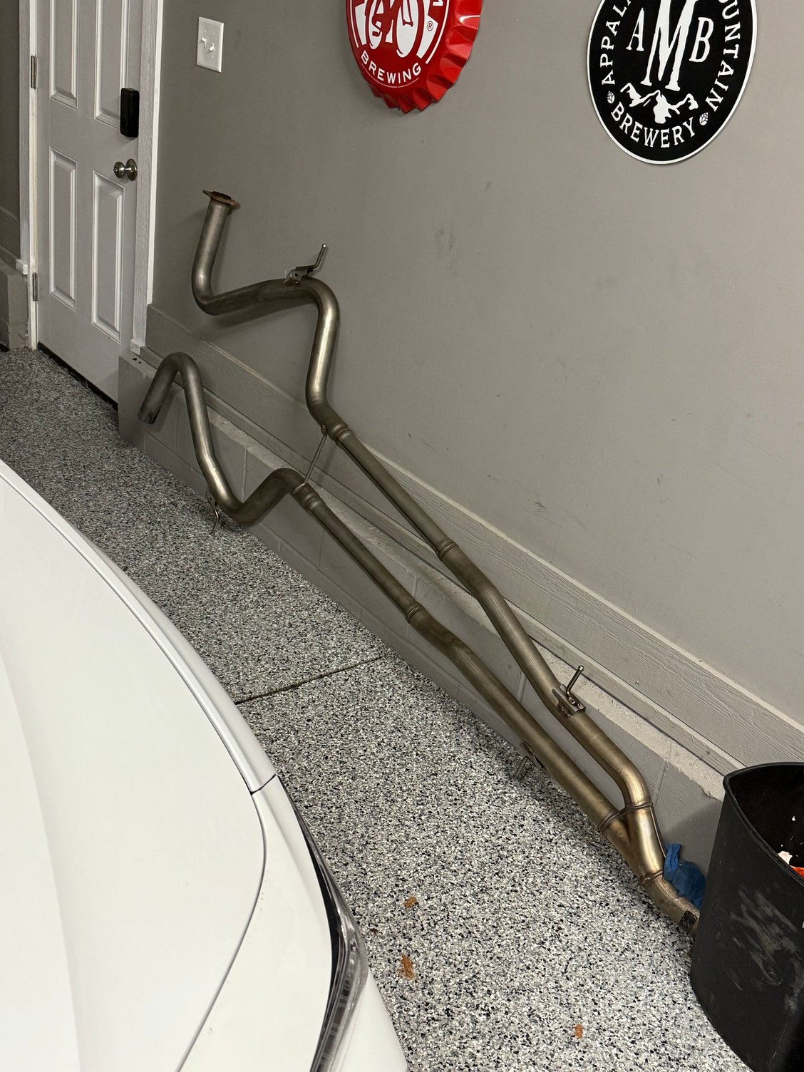

Was finally able to find a Type-S exhaust in Charleston SC. Picked it up, brought it home in my TLX and installed it. Honestly, it's NOT a difficult job and only requires 3 bolts to take off and 6 rubber exhaust hangars to drop the exhaust. I did it alone, but having 2 people under there will make things go easier.
Difficulty Rating: 2 out of 5 (5 requires Acura to perform the work)
Time Required:
  • 2 hours (depending on your aptitude). I could do it in 1/2 the time now, after going through this once.
Tools Needed:
  • Car lift OR a floor jack with 4 jack stands to raise the entire car off the ground.
  • 1, 14mm socket
  • 1 LARGE screw driver (12" to 15") or a crow-bar of similar size.
  • Lubricant (e.g. silicone spray)
  • PB Blaster (or equivalent)
  • Anti-seize gel.
Steps:
  1. Lift or JACK up the car so that all 4 tires are up in the air - be safe, ensure the car is solid while lifted
  2. Crawl underneath and spray the 3 bolts holding the exhaust system to allow the oil to penetrate (see picture #1).
  3. Crawl towards the rear of the car and take off the first 2 sets of exhaust hanger bushings. Spray with lubricant to make it easier to take off. NOTE the orientation of the bushings as noted in picture #2. The ARROW should point in to the car, not out to the car for each
  4. Next unhook the exhaust hangers at the rear of the car. Spray with lubricant to make it easier to take off.
  5. At this point, the only thing holding the exhaust are the 3 bolts and the middle exhaust hangers.
  6. Loosen and take off the 3 bolts
  7. Place something under each of the rear mufflers so that they are held up by this box/board/bucket
  8. Remove the last 2 exhaust hangers. Be careful on the last one b/c the exhaust could drop.
  9. Slide the exhaust rear-ward off the 3 bolts and it should be free
  10. Clean each of the exhaust hangers and then spray silicone lubricant in EACH of the holes to make it go on even easier.
  11. Install is just working back from step # 9 to step #1
Notes:
  • REMEMBER THE ORIENTATION of each of the hangers as you pull them off.
  • Clean and lubricate each of the holes for each of the hangers. I plugged each hole with my finger and filled it with silicone lubricant.
  • The entire exhaust weighs TBD pounds. (I need to weigh it one of these days and put this data point here).
